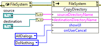

One way is to use Windows own file copy function and show the UI:
Certified LabVIEW Architect
Message 2 of 19
(2,952 Views)
Thanks for your answer. That's good. But can I specify the location to open this window?
--Is there an alternative way that can be used directly in labview.
Message 3 of 19
(2,940 Views)

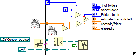

Even the windows copy dialog is just a guess and often gets it wrong.
What is the folder structure? For example if there a a large number of similar folders (e.g. test results), each with a similar number of files of similar size and no subfolders, you could iterate over the folders in a FOR loop and copy each. You know how many there are, and after one copy you also know the time it took for one. With some math, you can get a better and better estimate on the time left to do the rest.
Message 4 of 19
(2,909 Views)
Accepted by topic author DavidHammer
Here's a quick draft. Probably needs some tweaks, nothing a +1 or -1 in the right place cannot fix. 😄
