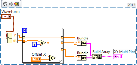

Filter is not my requirement as I want to make delayed copy of signal and want to visualize it together.I have uploaded a VI in which I am extracting waverform components and in time I am adding delay and construction delayed version.Then I am merging the two signals to visualize together.The whole filter activity I have done is because my sensor is picking two signals and regrdless of proper acquisition, Whatever signal I recieveafter filtering , I am am making delayed copy of it.This is all I want to execute.

I apologize for the confusion of what you were looking for.  I was able to offset the X-Axis of one set of data using a XY Graph instead of just a Waveform graph.  See the attached VI.
