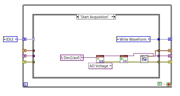

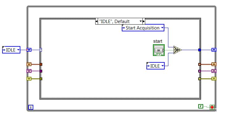

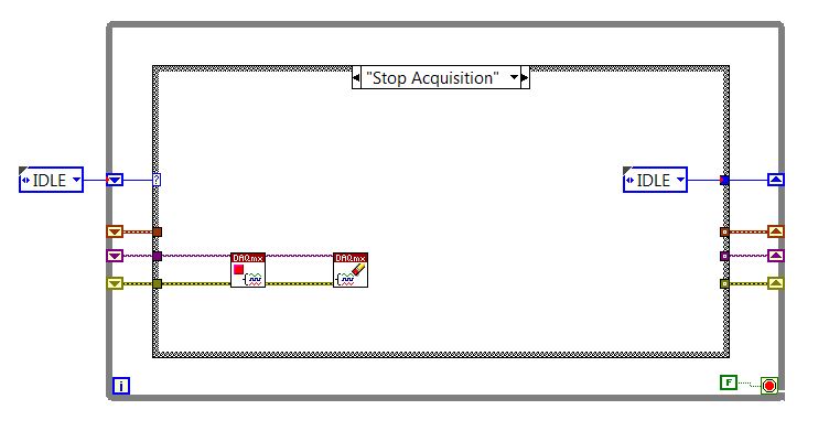

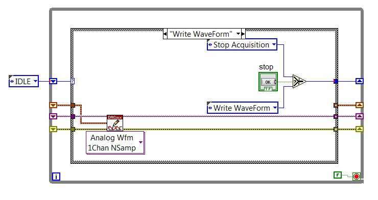

I've met problem with realisation of signal generation control (START/STOP) using state machine.
There are 4 states in state machine (please see 4 screenshots below).
The problem is when I click on START button, only short series of pulses generated.
Is it problem task_in/task_out staff, that isn't properly managed ?

Your waveform gets reset after the first Write because you didn't wire it through. It is being set to a default value for each subsequent write.

You're just writing the same waveform over and over again, right? Your Start Acquisition state creates a square wave and writes it to a shift register. You then read that shift register in Write Waveform, but you don't pass the waveform back through the shift register again, so the waveform is lost.
LabVIEW programming is based entirely on dataflow and parallelism. This is incredibly powerful and has lead to its success over the years (coupled with the graphical programming), but is usually one of the first things that new developers stumble over. The Highlight Execution feature is a great way to watch how your application utilizes dataflow. Your dataflow needs to keep the waveform data through each state.

The button "STOP" still doesn't work.

I edited your VI with some improvements. See attached.
The Stop button now only stops acquisition and I added a Stop Application button. The error gets taken in to account with every state along with a boolean output, so it can be stopped other than with the error cluster.

When clicked shortly "STOP" doesn't work, but when I keep it pushed about 1 sec, it works
Message 7 of 10
(6,829 Views)
Accepted by topic author Pavel_47
Oh... you have it set to the mechanical action Switch Until Released... Right-click it and go to Mechanical Action > Latch When Released. Do the same for your Start button.
It was taking you a second to read the value while held down because your acquisition Write takes about that long apparently.
The Stop Application button I made is set to Switch When Released. It is set to Switch so that it can be used as a local variable in the Stop Acquisition state as well as Idle.
