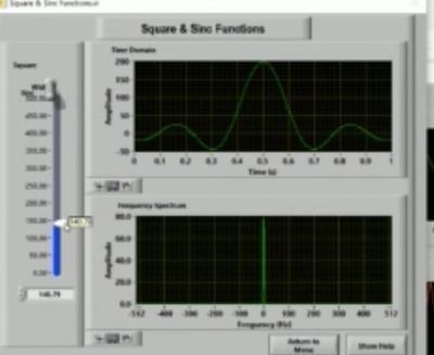

Hey @altenbach!
PFA my latest attempt at it. I've made changes that help me get the 200 amplitude but I still don't get how to view the sinc function within [0,1] reaching the peak at 0.5.
What I basically want is this:
Please bear with the poor quality.
(2,902 Views)

The sinc function is centered at zero, meaning your x-axis fails to correctly define x0, while dx seems to be defined, but also incorrect. To get your twisted x-axis, just do the calculation for x= -0.5..0.5 (after your custom scaling), then set x0 to zero.
Maybe you want to start with the plain sinc function instead of sinc pattern.
It seems more and more like homework, especially since you seem to intentionally blur the image from the homework assignment, potentially to prevent us from doing a reverse image search on it. No tricks please!
