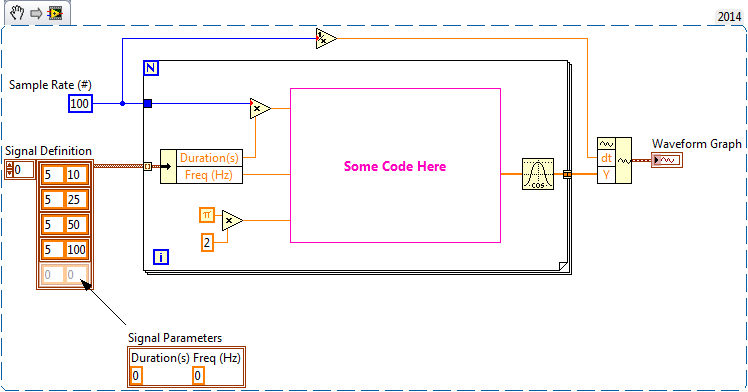

I really think we shouldn't do you homework instead of you but here could be the possible way how to do it more scalable. Basically you can generate and concatenate signal segment for each item in the Signal Definition array. Sample rate will be just another input parameter of your signal generator.

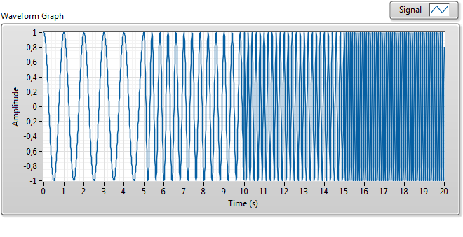

.. and the result can look like this:
