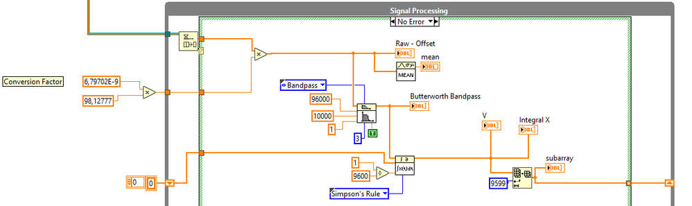

First I use a bandpassfilter to adjust the signal from the sensor offset: Sampling frequency 96.000, frequency range from 1 to 10.000 (This describes the linear range of the sensor. I also set init/cont to true, so LabVIEW initializes the internal states to the final states to filter the signal, otherwise I would receive a sawtooth wave. This works fine.

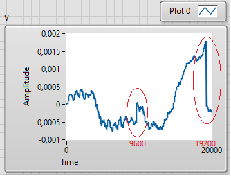

In the next step I use Integral x(t).vi to get the velocity signal. I set the sampling interval dt to 1 / 9.600. Unfortunately this vi doesn't have the init/cont input from the Butterworth Filter.vi so I get a leap to zero after each array of 9.600 entries. This is how it looks:
I already tried to use the last entry of the array to make it the Initial Condition of Integral x(t).vi but as you can see this didn't make any difference.

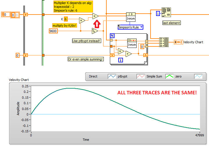

You have so much noisy data, that fancy integration algorithms can be replaced by simple summing (you'll get the same as with the ptbypt, another alternative). Note that your data has the steps while both the ptbypt and simple summing does not.
Do you really want to do bandpass filtering? Doesn't that also remove DC components that might be interesting? Not sure, but look into it.
(Frankly, I never really bothered with the initial and final condition settings of integration because I don't understand them. Maybe somebody else can enlighten us)
I reduced the history length of the various charts to five datasets. (Some of your charts were set to 32M(!!) DBL points, which is crazy! Maintaining a quarter GB buffer per chart seems unreasonable, even more so if the charts are only a few hundred pixels wide 😮 ). Front panel elements are not for massive data storage. Data belongs on the diagram!
(3,051 Views)
Accepted by topic author Kern86
OK, when you read the help between the lines, the last elements needs to be multiplied by 6/dx (Simpson's rule) or 2/dx (Trapezoidal). Now things fall in place and all three algorithms give basically the same result. I still recommend the simple running sum!
