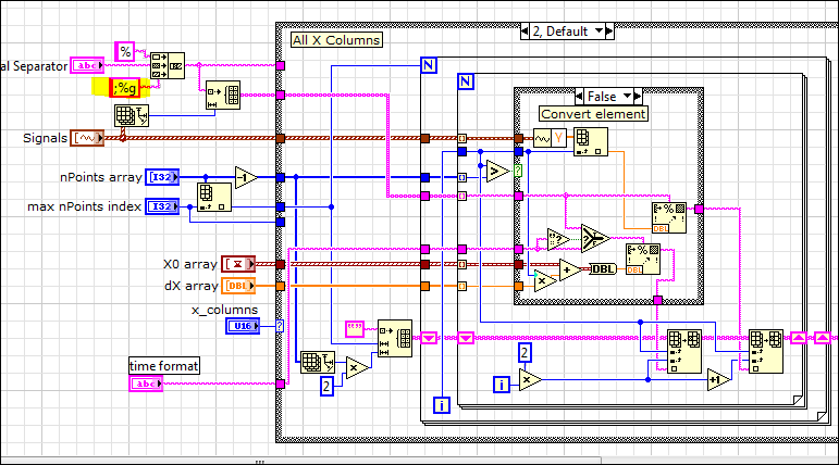

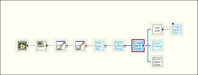

Caution! This will change files in vi.lib. I suggest you rename and move the affeted vis (do not blame me if other things break)
Convert the express vi to a vi
Drill to here in the heirarchy
Change this constant format specifier

Jeff, I think I tried this method before...exactly what do I put in the string to output only 3 significant digits?
Message 8 of 11
(6,370 Views)
%.3g
