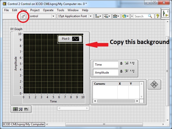

Take the Silver XY Graph and customize it.
Copy the background image of the graph and paste it into another "working" XY graph from the system or modern palette.
Your graph will now look like a silver style one, and have the legend scale/position properly.

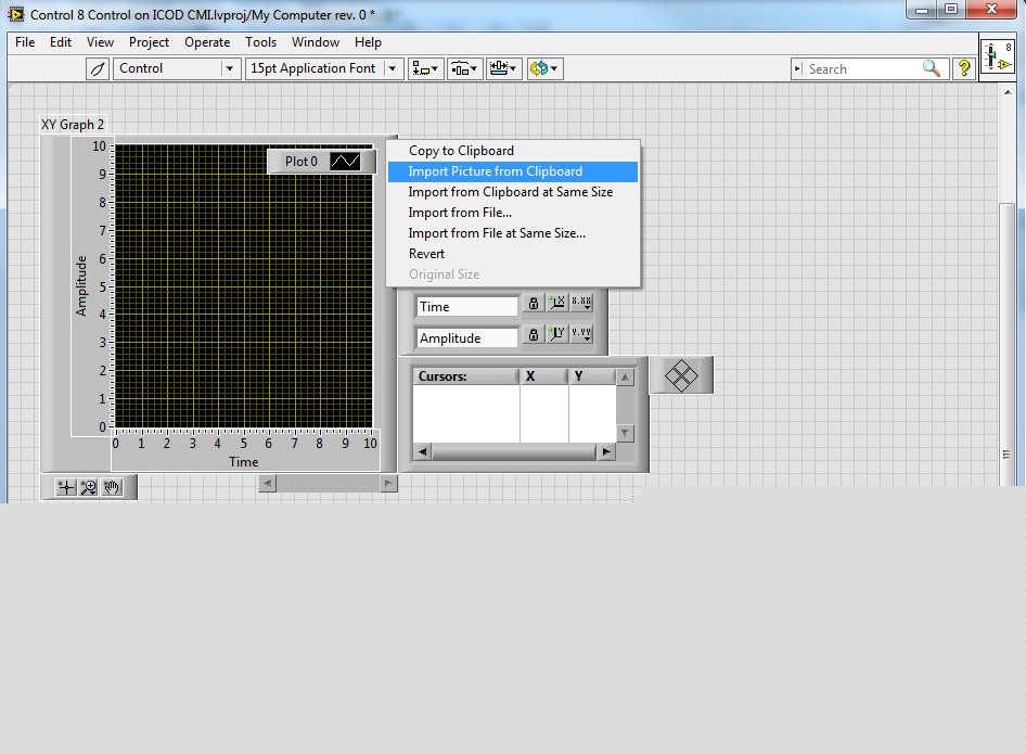

COPY - Please use "Copy to clipboard" by right clicking on the background
PASTE:
Please note that only the background of the graph will change. The rest of the elements such as the legend will not be altered (I did specify this was a cheap workaround :P)
In my case, this was not an issue, since I was only displaying the legend (which I made transparent anyway).
