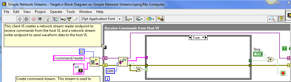

In Simple Network Streams - Target.vi the receive loop has no timer, but the Read Single Element from Stream VI has a timeout of 1000 milliseconds connected.
How can the target receive loop work without a timer?  What is the purpose of the 100 millisecond timeout of the Host receive loop if the loop has a timer of at most 10 milliseconds?
It can work without a timer because if it's actually running, it sits and waits for the other end to send data.,  It is the sending end which times things - the receiver just receives it when it's sent.
The purpose of the 1000 mSec timeout is to catch the case where the other end stops sending. If the other end stops sending, but keeps the connection alive, then there is no "error" but the timeout stops listening and gives you a chance to do other stuff, like check for the "STOP" button here.
