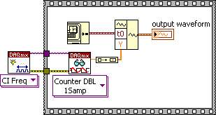

No, the DAQmx Read Counter does not have a waveform data type option. I don't think you can do anything else except use the Get Date/Time function and create your own waveform.

Thank you, what is that symbol between the DAQmx read and the Build waveform and where can I find it? Also does this have to take place in a Flat Sequence or can it work in a while loop?

Hi Noel,
that node is a "build array" from the array palette.
The sequence frame is needed to get the time when starting the DAQmx read operation. Without the frame you would (most probably) get the time when calling the init function... Think dataflow Smiley Wink
Message 7 of 10
(5,097 Views)
It's the Build Array function and it's on the Array palette. It's there because in thje example I used, the DAQmx Read returns a scalar and the Waveform data type requires an array for the y data. I used the sequence structure just to try to get the timestamp at about the same time the DAQmx Read is executed. It's not going to be extremely precise but if you have a lot of other things going on in the loop, it's going to be a bit more accurate. The entire thing could be placed in a while loop.
