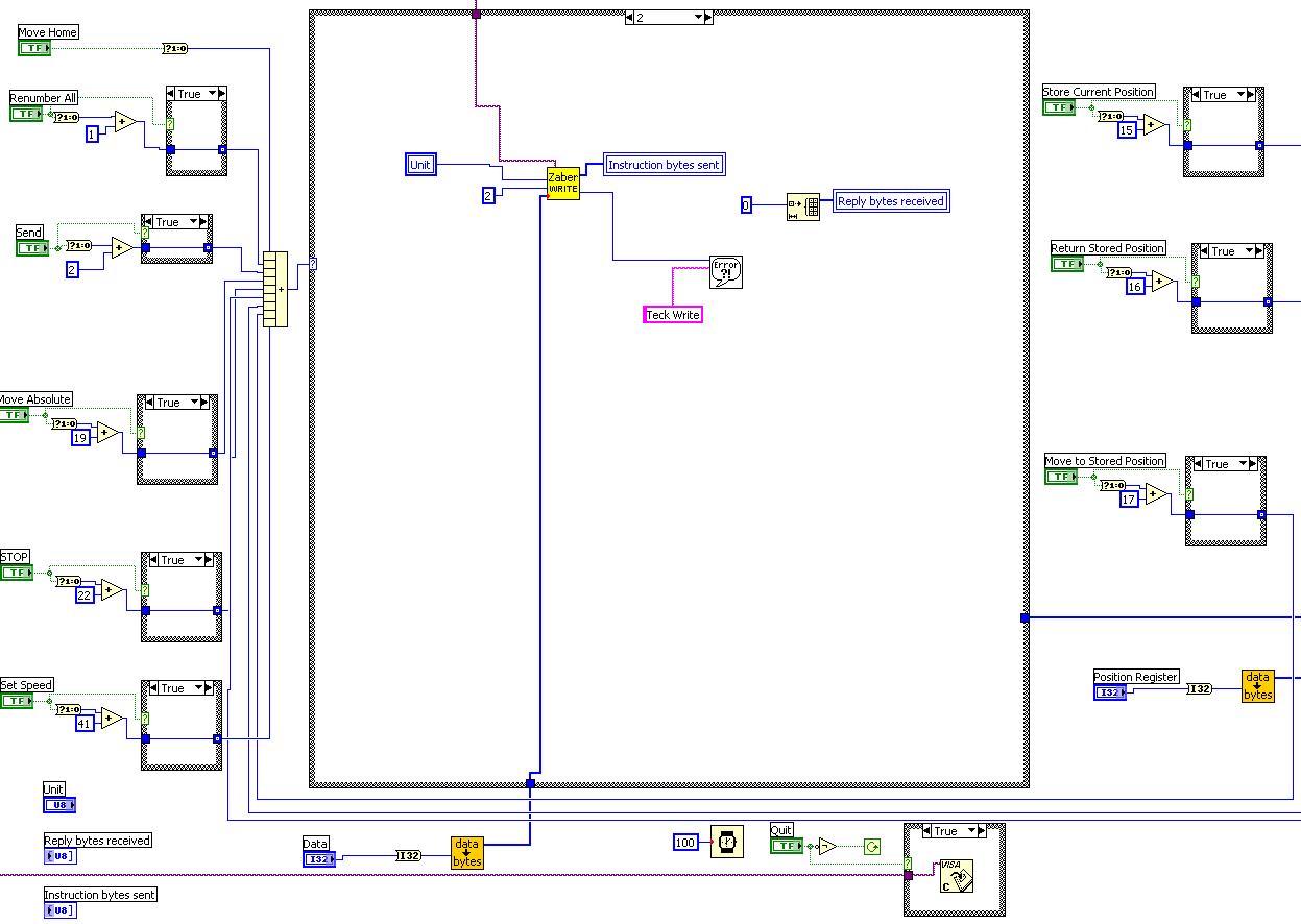

A vi I am currently working on needs many buttons on the front panel. However, the execution for each is quite simple and similar all throughout.The following figure shows the buttons on the left and right side of the Case Structure. Inside the Case Structure, the same commands remain essentially the same except with the change of a number as the input of the Zaber Write vi (in this case it is a 2). Does anyone have a better idea for me to execute these functions in a more compact way?

you can just use the select.vi for those small case's.

What version of LabVIEW are you using? Don't you have the event structure available? You could eliminate all of those adds and case statements if you do. Can you post your VI?

Is it possible that more than one button could be pressed at a time?  If so, then an event structure might not help.
But if more than one button could be pressed, then the numbers that are added don't make sense.  You would think they'd be a binary series.
Regardless,  this would be a simpler implementation.  (I shortened it to just 4 buttons.)
By the way, if you make your loop terminal, Stop if True, then you can get rid of the Not! function going into it.

It depends if your buttons are switch action (any combination of buttons can be true: 2^N possible cases)
or latch action (only zero or one can be true: N+1 possible outcomes).
Here is code for both cases as shown.
(If you want some weird, nonconsecutive case numbers, you can index into a lookup table before going to the case structure.)
Overall, your code shows some very odd programming style that makes little sense. Can you attach the actual program?

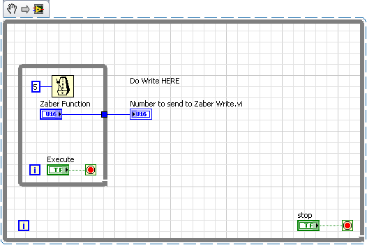

From the looks of things you will only send one command at a time to the Zaber device.  I would use a type def ring control (set to allow non-sequential values Properties>edit items>uncheck"Sequential values") and send the value to the Zaber.
Code an control are attached Pictures worth 1000 words
