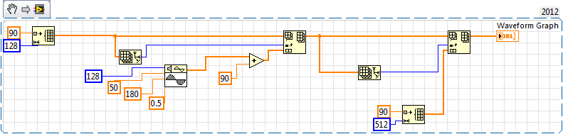

Here is how you could accomplish the first thought.

Looks fantastic,should I change the properties of the graph if I want it to show it goes down to 0 degrees (but have the turn still at 40 degrees)? If I implement a while loop would it repeat the "dip" so to speak?
Thanks again for your time.
Kind Regards,
Mark.
