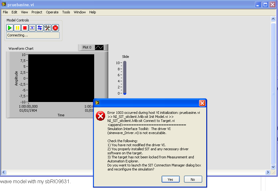

But when I try to map the in and out port of the model to a HW I/O I get this error:
What causes this error?

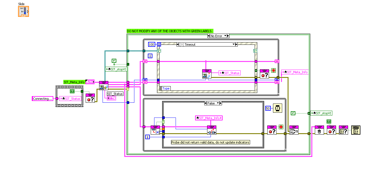

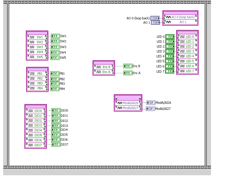

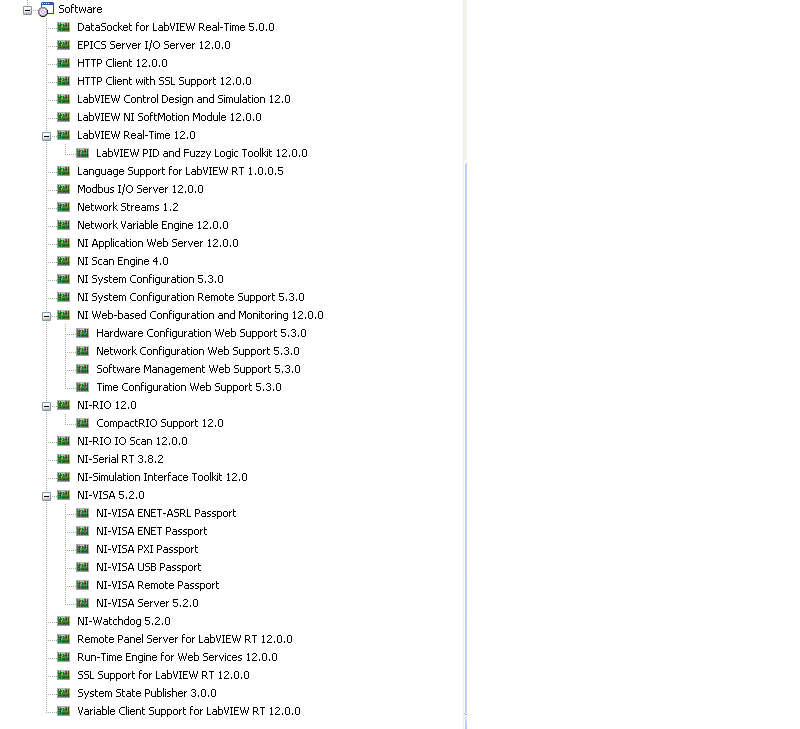

I have exctly the same issue. here is my error
my fpga for the bitfile
bitfile.PNGmy driverVI
and my installed software
(4,880 Views)
