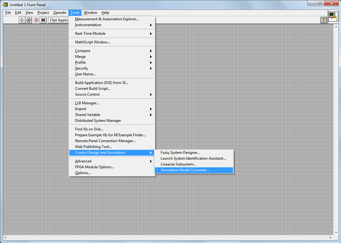

If you have Control Design and Simulation Module, you can use the Model Converter to convert your .mdl to LabVIEW VIs.
