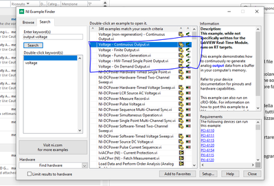

    • Have a look on the LabVIEW examples. You should find some useful examples for voltage generation:
