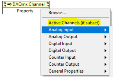

You can try to set the subset channels using the Active Channels property before setting the filter setting. I have never tried that so I am sure if it will be supported but no harm to try.
