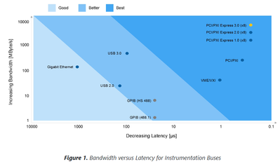

If CAN is not possible, you should use RS-232 or USB instead of TCP/IP. Ethernet has the worst latency performance. RS-232 has the lowest latency but it would require you to use the onboard RS-232 port. If you are using a USB-232 adapter, you should just use the USB to communicate with EA-PSI directly.
Reference: Instrument Bus Performance – Making Sense of Competing Bus Technologies for Instrument Control
