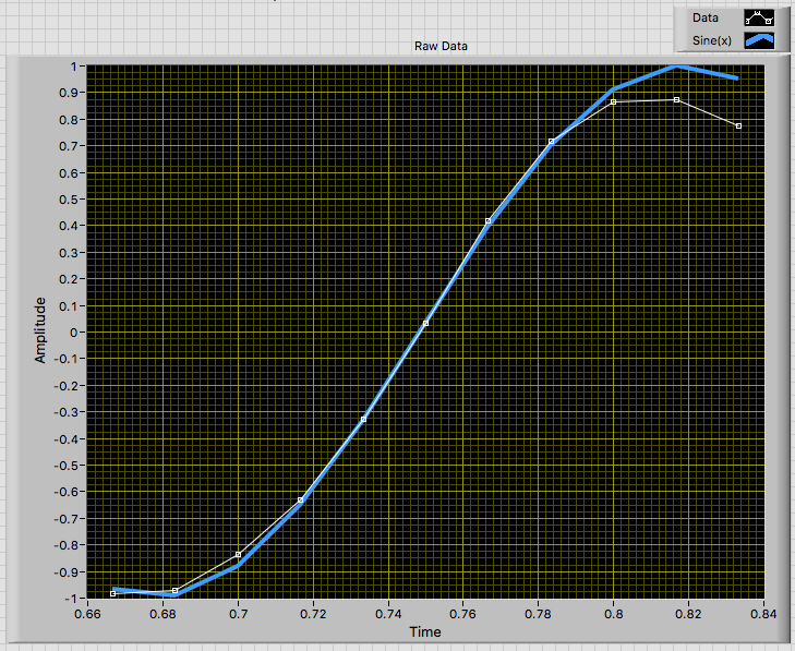

I have evenly sampled data, where each data point corresponds to a point on a sine wave.  I need to detect the peak of the sine wave during a particular time window, and so I need to fit a sine wave to my data points.
For now, I have used a polynomial fit (attached LabVIEW 2013 code and screenshots), but this isn't good enough. Each data point I have should be on the sine-fit line.
Is there any way of doing this in LabVIEW?

The data you posted is not very sinusoidal. The image below shows a "manual" fit of a sine to your data. I adjusted the offset to match the zero crossing and then a multiplier to match the slope near the zero crossing. The plotted fit is sin(m*(x-b)) where be is the x value at the zero crossing and m is the multiplier.
Peak Detector.vi seems to work OK with your data. It finds the peak as x = 0.8096, which appears reasonable.

@Bob_Schor I don't know the frequency of the sinusoid. I just know the sampling frequency.  Example data is shown in the screenshot I attached.

Sorry, I didn't look at the pictures (pictures are almost never data, they are at best "pictures of data").  However, now that I have, I "see the problem" -- you may only have a fraction of a sinusoid represented by your data, which makes the problem "problematic".  A sinusoid is characterized by four numbers -- offset (DC value), amplitude, phase, and frequency.  If you have multiple cycles, you can estimate frequency, and if you know frequency, you can estimate the other three parameters easily.  If you have less than a cycle, the estimation problem becomes much more difficult.
I will repeat my request.  Can you attach a (complete) set of data?  I can't do any computations from a picture -- I need numbers (or a file whose format you describe to me so I can extract the numbers).
