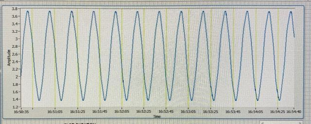

I have been trying various troubleshooting methods and one is this : Disconnected the AO0 output from the AI0 input and instead fed a 10Hz sine wave from an external Function generator. The Plotting was happening as expected.  But when I try the same by looping the AO0 to AI0 via the terminal board I just get some spaced out spikes.  See the pics attached.
With External FG FeedWith External FG FeedWith Feed from AO0With Feed from AO0
I am now not sure if the AO0 can feed the AI0 of the same board ?/
Thanks so much for the points on the X-Axis markers and spacing. I just have one query - the chart history talks about "points" . What exactly is a point ? Is it a single point on the plot irrespective of the data type that creates the point ?
