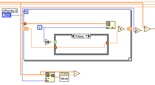

- You have a mixture of Extended Precision, Double Precision, and Integer data types. The mathematics is all done in Double precision in your code so why not just use that data type. [Note: At first I thought this might have been part of the problem with your code due to round off, but I think I found something else.]
- Duplication of code: When code occurs more than once It should usually be converted to a subVI. Also, duplicating constants (like the 16000 wired to for loop N terminals) can become a problem if you ever need to change the value: Did you find and change all of them?
- Rube Goldberg code: The for loop with the unitialized shift register (probably should be initialized) and the divide afterwards can be replaced by Array Subset and Mean.vi. This much more clearly indicates what to code does and takes up much less block diagram space.
