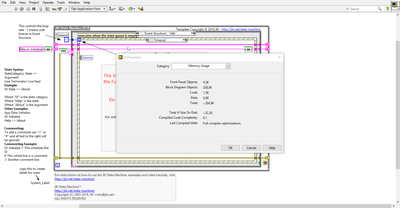

That's really a small size. I placed a JKI state machine in a new VI and the value on the block diagram is 250K. So I don't know how you can do it.
The small example that I attach communicates with two spectrometers, one camera and uses a NI MIO.
Can you describe what are you doing on your "super-busiest" main?
Thanks for your help!
Sure, I have several loops doing different things with two queues and several dynamic events.  It is highly modularized, though  I don't really have anything but subVIs at the main.vi level.  That's probably why it's so small.  All my loops are in subVIs.  The complexity is 0.5.
