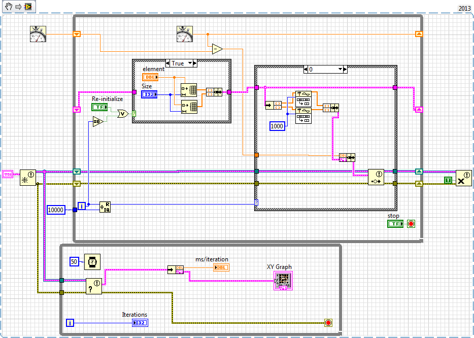

I'm working on a data acquisition program and am trying to implement some of the suggestions I've seen on this forum for handling large arrays and displaying them.  I think I'll have more questions on this later, but I've run into a surprising effect and wanted to see if you guys could help explain it.
My plan is to keep my data array in the shift register.  I will initialize and use replace array subset to reduce memory reallocations.  Since I am plotting the array directly, I don't want the initialized data showing up on the plot, so I am initializing the arrays with NaN.  My observation is that it takes much longer for a labview plot to update when writing NaN than with a real number of the same representation.
Interestingly, the loop processing the data and sending it to the plot is not slowed down by this effect, but the plot itself updates much more slowly than the loop does.  I'm including an example program to illustrate the effect.  With it, you initialize an array and the loop continually sends the array to the plot with or without decimation (by a factor of 100).  Indicators show the ms/loop iteration and the current iteration count.
As expected, making the initialized array larger slows down the loop and decimation speeds up the loop, but I didn't expect the intialized value to have such an effect.  A couple of scenarios to illustrate the point:
1) Set array size to 1,000,000 points and initialize with zero and no decimation.  Notice the ms/iteration and how quickly the iteration count seems to update.
2) Now change the initializing element to NaN, and re-initialize.  Notice how the ms/iteration is the same, but the iteration counter is clearly updating much more slowly. In both cases, I note that the memory assigned to labview is about the same (although large).
I realize the more elegant solution would be to reduce the size of the array before plotting (something I'm working on), but I am still curious about this effect.  It is hard to quantify since labview seems smart enough to keep the loop going even if the front panel is struggling to update, but the effect can be clearly seen.
What do you guys think?  Any explanations?

Actually I see 1 %20 improvement in loop speed with NaN  (Makes sense there are a lot fewer pixels to render for the draw)
Let's see what VI Analizer shows....
Whoops dead code here.  Watch those apparently wired tunnels!
But nothing to indicate any major issues with the FP like overlapping objects.  (when objects overlap BOTH need to be redrawn when either are redrawn)
One other high priority result:  Wait in while loop: This While Loop containing a front panel control terminal appears to have no way to regulate its speed.  If this is a subVI, consider moving the control terminal outside the loop.  If this is a user interface VI, consider using an Event Structure to monitor front panel activity.
That means we are really overloading the UI thread  but we actually DONOT want to slow the while loop.  Hmmm...
Time to bust out the template design patterns.  The User cant really see updatdes faster that once every 50mSec
So we can try to move to a Master- Slave pattern
Running this we get a 2x boost in the top loop speed but add a data copy (or two) of a rather largeish chunk of data 100x/Second so we service a lot of memeory movement.  better but not quite what we want.  Super ideal for smaller arrays though: jot that in your notebook - Try the code with smaller arrays like 100K and loop speed goes into the dirt.  so now it really is memeory operations that are throttling the UI.  managable.

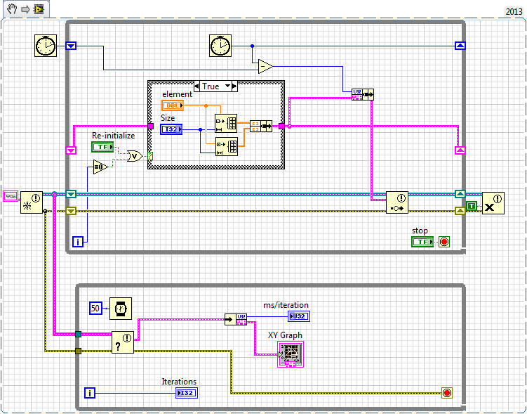

You might squeeze a bit more out of it using a DVR but I figure improving your loop speed by too much more than the few thousand times I did in 10 minutes might just make you angrySmiley Wink

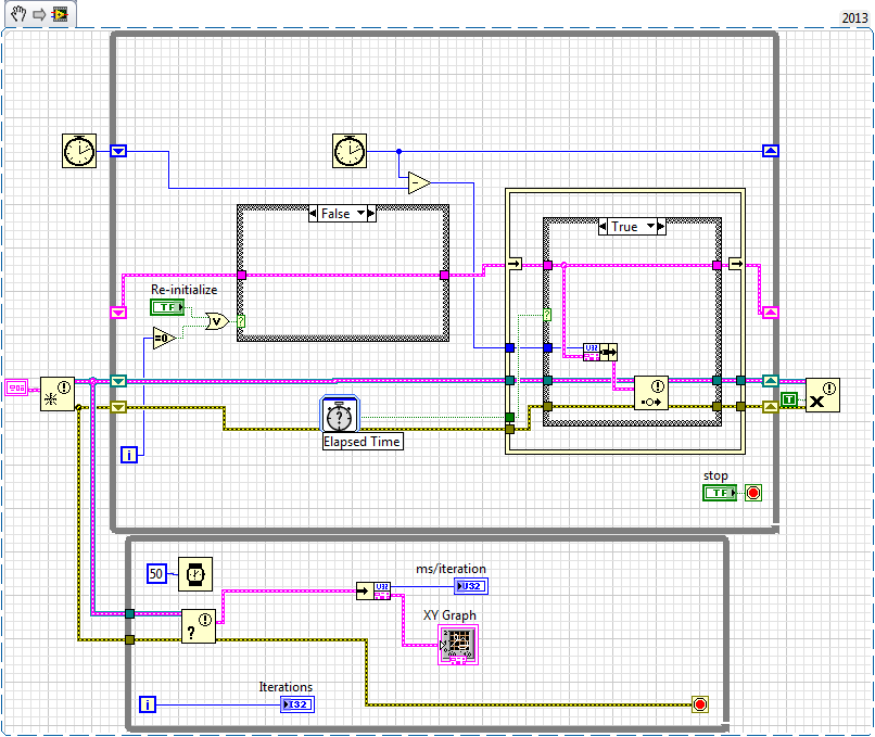

Just to prove I could go there:
While having a smoke I realized a few things.
The xvi is SLOW:
I needed a more precise timer (luckilly there is one)
No need to duplicate the WHOLE data cluster
the IPES isn't really needed with the 2013 optomizer
Loop time is <2uSec at 25M (there is only finite memory)
25m/2u >12,500X speed at 25X data sizeSmiley Very Happy
Don't be angry
Edit CA the NaN did graph %20 faster at 1M points
