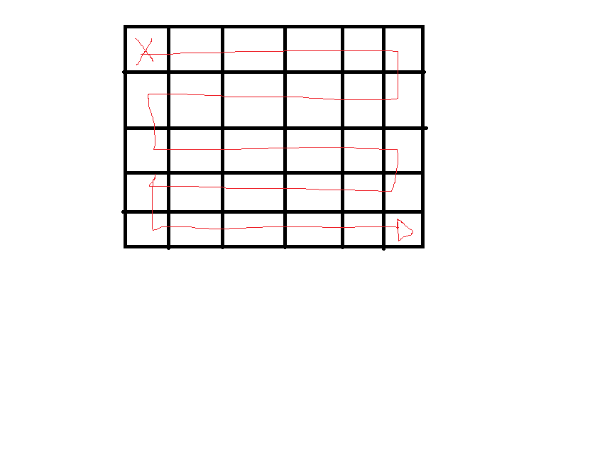

This was my original guess at a solution, but I forgot to mention that I have two stepper stages (x and y-axes) and I could not reason a way to do the single steps in 2-dimensions.
For instance, this would work flawlessly if the x stage just steps from its initial position to the end (just looping one step). But here, after the x stage steps to the end, the y stage must step up once, then the x stage must step back to the initial position, then the y stage would step up once more, then repeat. But during this process, the main VI does not update.
I attached an image of this process for visual aid.

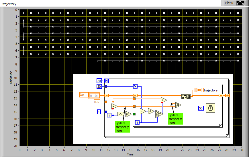

Such a trajectory is trivially simple to generate. None of this explain high resource usage. Maybe you could show us the entire VI.
Message 6 of 9
(2,145 Views)
@altenbach wrote:
Such a trajectory is trivially simple to generate..
One possibility:
