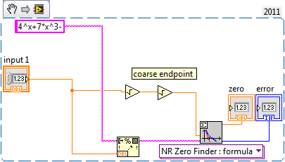

Accepted by topic author Roy-R1
Zero finder ???
Here 2,790615
Greetings from Germany
Henrik
