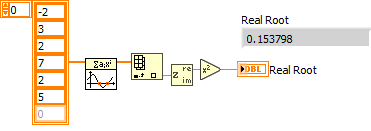

Don't forget that there will be quite a few more roots, some complex. In this case, there is one real root and you can find it as follows using this VI. (Of course you need to make certain assumptions about x). In the more general case, use this VI to sort out the real roots.
