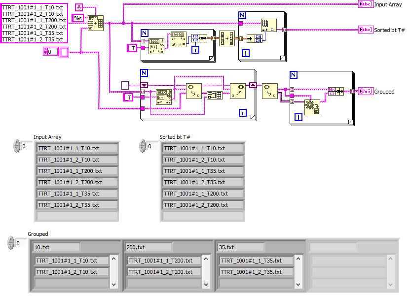

While the specifications are not very clear, here are two potential solutions that can hopefully give you some ideas (I took some shortcuts, so modify as needed to fit your requirements):
  1. Top code sorts the file names by the T# numerically, ignoring the rest.
  2. Bottom code create an array of clusters, each cluster element containing the unique key part and an array of file names matching that part. (Learn about variant attributes to understand the code).
