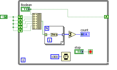

There's a lot of different ways to do this. If you go with numeric increment, you'll also have to clear it periodically if you only want to check the last 4 out of 6. One way is with a shift register. If you drag the shift register on the left side down, you get previous iterations. Then it's just matter of counting how many of the previous iterations and current are true. Here's an example.

Thanks for the help.  Anyother suggestions without using a shift register that can count the last 6 times? Also is it necessary to wire the false constant to the shift register? Maybe I missed something here.
Message 4 of 8
(4,375 Views)
Why would you be averse to using shift registers?  Dennis' approach is probably the most simple.  The false constant is not absolutely necessary, but it is good practice.  It is wired just so that you know the initial state of the registers with absolute certainty.

Thanks.  Dennis' approach works fine, I was just curious as to other ways this could be done. I had one other question. I am using a Write to Labview Measurement file VI also, but each time it is given the signal to save it just writes it in the same file. Is it possible to write to a new file every time? I have the VI inside a while loop. If you need more detail I can show you the program.

Sure there other ways. You can create a queue of 6 elements and each iteration dequeue all of them. You can create an array with only 6 elements and discard the oldest. I think the shift register is about the most straight forward to implement and it's pretty obvious what is going on by just looking at the diagram.
