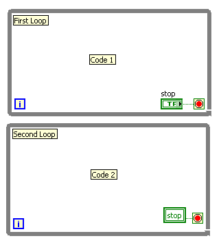

question bête...lorsque l'on se trouve dans une boucle while existe-t-il un moyen pour sortir de cette boucle en actionnant un bouton qui ne se trouverait pas intégré à la boucle ?

It is possible to create a local variable to implement what you want to do. Please find below an example where you have 2 While loops in parallel and one Boolean control which interact in both loops using right click on the stop control>>Create>>Local Vairbale.

this solution not work. when I tried to apply it, it gave me the following error message : Boolean "stop" : boolean latch action is incompatible with local variables
(3,366 Views)
As your error mentioned boolean latch action is incopatible with local variable. So modify it (cf. this link) Smiley Tongue
