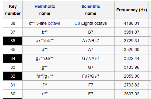

Lets take the example of Piano, it has 88 keys which mean 88 tones, each tone has it own frequency.
For my project, if the user chosse the input tones of Key88(4186.01Hz) and Key86(3729.31Hz),
then the expected output of averaged tones should be ( (4186.01Hz + 3729.31Hz) / 2 = 3957.66Hz ) ,
which mean the output tone is close to Key87(3951.07Hz).

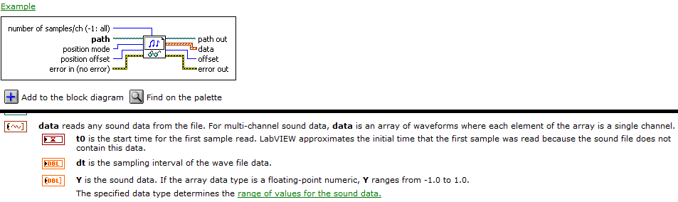

I use the  "File Path Control" to read the tone files and wire it to simple read
                                           Sound files(wav)                                                                  Front Panel                                                               Block diagram
I was studying the output of simple read, because the information tell me the data is an array of waveforms, so I guess to get the averaged tone,
maybe I should do the way
a) put them in wavefomrs, average the 2 waveforms, play the averaged wavefomrs
b) put them in array, average the 2 arrays , convert back to sound data and play it
By the way, I do not know implement both the ways, and I am not sure wheter the ways are correct.

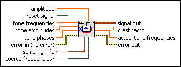

Hi!
There is this promising Multitone Generator VI:
https://www.ni.com/docs/en-US/bundle/labview-api-ref/page/vi-lib/measure/matone-llb/multitone-genera...
...but I have never used it.
