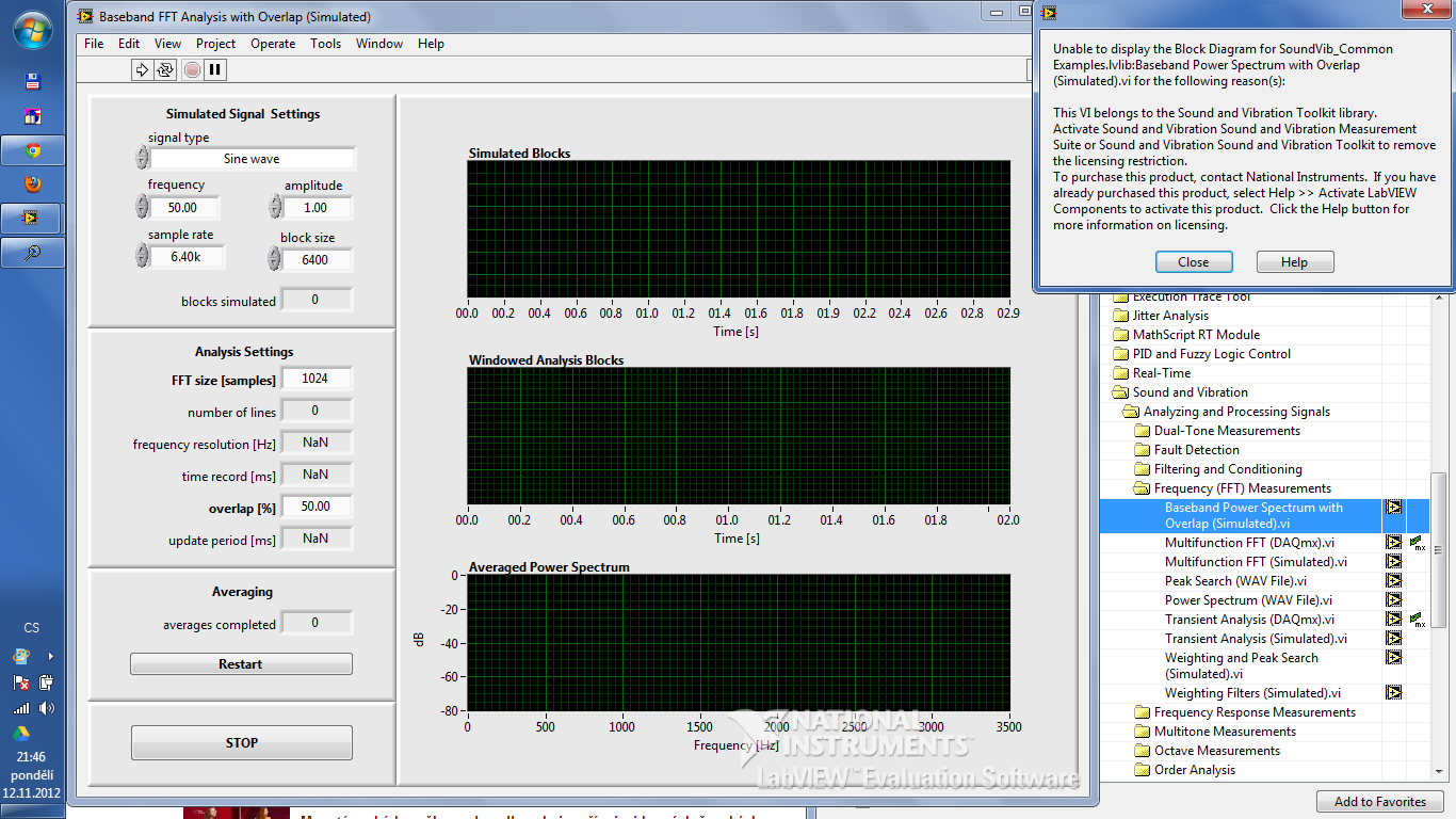

I am a student and I am using evaluation version of LV. I am trying to play with sound and vibration examples but I cannot see the block diagram only the front panel. It is writen to activate LV product. Do I need activate the SV toolkit to see the examples block diagram or does some evaluation version exist ?

It is definitely correct answer. Now I would like to have answer from someone who is less funny. There is screen picture explaining the question.

Hey Charlie,
Please refer to the following KnowledgeBase:
http://digital.ni.com/public.nsf/allkb/862567530005F09C8625675F00711756?OpenDocument
If you are using the evaluation version of LabVIEW, "you will not have access to block diagrams of VIs not available in the Base Development System."
Your options are:
1 - Purchase the Sound and Vibration Toolkit (and LabVIEW as well),
2 - Purchase the LabVIEW Student Install version of the Student Edition, (only this version includes measurements of sound and vibration): http://www.ni.com/labviewse/compare/
You can check with your university/college to see if they have purchased the toolkit.
Hope this is useful,
Norbert
