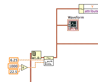

You need to connect the scale factor (1000/22.5) to the Scale input and the waveform to the Wavefrom in.  The data you posted 11 January also ppears to have an offset of about 6.25. When I connect those values to scale and offset, the data seems to clean up nicely.
Lynn

Ohhhhh yeah 🙂 That's it! Thanks again 🙂

I used the "calibrated eyeball" method. I looked at the waveform graph of the signal after scaling but with no offset. It looked like the baseline was about -6.25. When I put 6.25 into the offset, the baseline went to near zero.
A more determinsitic method is to use the Basic Averaged DC-RMS.vi from the Signal Processing >> Waveform Measuerments palette. First scale the data (because the offset is applied after multiplication). Then measure the DC component with this VI. Then apply the negative of the DC value as offset.
The Scale and Offset VI does a simple linear scaling y = m*x + b, where x is an element of the input array (confusingly, the Y component of the waveform), m is the slope, or scale factor, and b is the offset. This is explained in the Detailed Help file for the VI.

Your eyeball is really accurate, I measured DC and the result was 6.31 🙂
