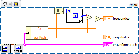

Hi Gada,
ofcourse LabVIEW can calculate FFT results!
