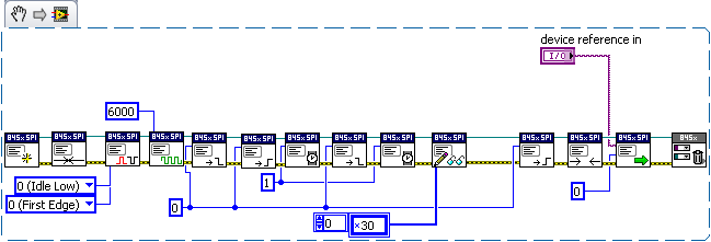

Which is why I'm sending a 0x80 to read register 0x00 (W as 0 bit and B= burst access bit, must be also 0 to do a single reading) and then I suppose I should send a dummy byte in order to get 2 bytes out of the chip (the last one being the data, according to the diagrams of the chip's design note)... I send a random byte, I send nothing and I still get a number which makes no sense for me, but it is always the same and it's on the index 0, so no idea. I expect to have the reset values because I send first the SRES Strobe (in the design note explained) and I wait about a millisecond until I run the program again so I think MISO should be low by then meaning the chip has stabilized... because I haven't yet figured out how to read the MISO signal alone (help with this is also very very appreciated!!)
Thus, maybe I'm not even writing correctly the SRES strobe :robotsad: I don't really know what's happening. To read I would send a bit 0 to write another 0 to make it single access and then the 6 bit address of the register, and then immediately the 8-bit data I want to write, but for the strobes one must not write any data, just a particular address like 0x30 which is SRES, so that's what I'm sending.

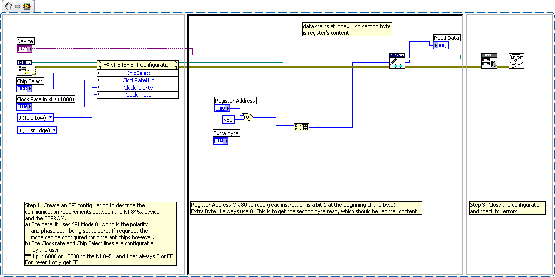

First of all, thanks for your answer, I appreciate your time.
Second, okay... I did try that a bunch of times before but no luck. Here is the snippet
But I don't get any useful information. I think the problem may lay on the physical connection but when I only connect the 4-Wires, I don't know how to supply the voltage, but I do still get readings, none of them accurate. My boss really doesn't know how the evaluation board works, and I've looked everywhere for more info and no luck. They only give the pinout for the Port B which is the one that has the 4 wire SPI Interface in the document I linked previously, and the Atmel in the other NI Tutorial is connected to VCC and GND.  I've also tried that (but my board says 3.3V, I still connect the 5V output of the USB 8451 to this terminal) and I connect one of the GND of my evaluation board to one in the USB 8451. All I get is FF, no matter what I do, even for a Chip select that it's not even connected (I know SPI offers the master no way of knowing wheather it's being listened or just talking to air). How to know what I'm doing wrong, then?

I know I should send the address OR'd with an 0x80 to read and with a 0x00 to write. I should send a dummy byte when I read (can be anything I think) in order to get the 2 bytes out of the device in which case the second one is the content of the register I addressed. Sounds simple enough! I also read that I have to reset the chip first or it is in unknown state. That was the main reason for using the Script. They say I have to pull CSn low and then high, and wait for at least 40um (microseconds) and then pull CSn low again and issue a "SRES" command strobe, which is writing the address 0x30 with no data (or any data I think), that's how you issue the strobe. I do it, and that's when I get all zeros. And they should be all the default values, which are definitely not all zero. Here is my coding... (correct if wrong)
Please offer any kind of advise or experience... 😞 I feel lost. I understand but I can't get anything that makes sense out of it. Should I use an additional voltage source and just connect the 4 Wires with GND or without GND?? I don't know if that would work. But is there anything wrong with the program? If there is please tell me, if there isn't I should start looking out for a way to fix a possible physical misconnection.  The proyect is quite urgent, so your replies and truly and hugely appreciated.

I've used the USB-8451 with SPI and it works fine.  My device also was a 3.3v device.  I connected 5v for the supply and used the 8451 as it is(5v logic).  This did not seem to bother the device I was communicating with.  However, your device may differ.  You may need to use level shifters in order to knock down 5v to 3.3v to the device, and 3.3v from the device to 5v for the 8451.
You do not need scripting.  I've never used it.  The 8451 will automaticlly set CS low when you write or read to any address.  If you need to set CS low then high, just read address 0.  CS will go low then high.  You don't have to control the CS line yourself.  Just use the simple write/read SPI vi's.  You need to connect all 4 wires (SCLK, DI, DO, CS), VCC, and GND.  The 8451 takes care of sending the clock, data, and chip select in the right timing order.
If the simple write/read doesn't work, I would try using level shifters to take the voltage down to 5v.  Read the specs on your device to see if it can handle 5v.  Try supplying 3.3v to VCC using a separate power supply.  Be sure to tie the power supply ground to the 8451 ground.  The 8451 should be able to see 3.3v from the device as a high.  Not sure how your device will respond to a 5v level for clock and data in.  Instead of level shifters, you could use a voltage divider made of resistors.

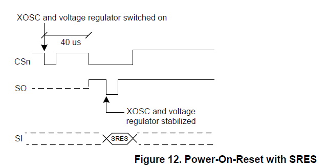

When the power supply complies with the requirements specified in the data sheet, proper Power-On-Reset functionality is guaranteed. Otherwise, the chip should be assumed to have unknown state until a SW reset is implemented (see Figure 12).
• Strobe CSn low / high.
• Hold CSn high for at least 40 μs relative to pulling CSn low
• Pull CSn low and wait for SO to go low (CHIP_RDYn). (How can I check the SO of my device??? There are no VI's that do that, are there?
• Issue the SRES strobe on the SI line. (which is sending 0x30 to the device)

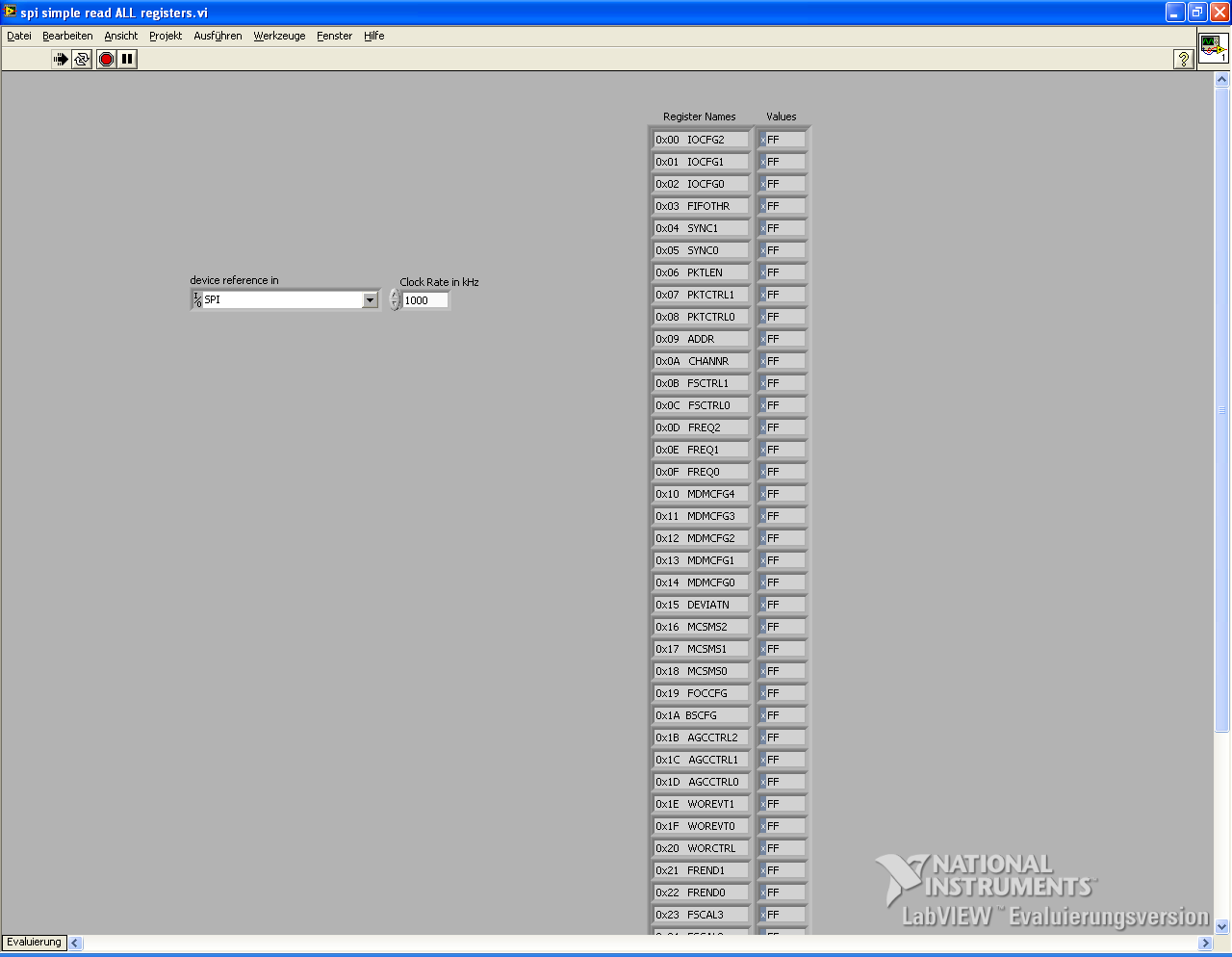

I've tried to read address 0 and I get those 0xFF, and when I try a new address it is the same. I don't know if that should be working.
How to achieve that diagram with using only the basic API?? Can anyone point me where my mistake is? I really know it should be something obvious that I'm missing but I don't know what. I've tried waiting and issuing the strobe but it doesn't change anything. Can these 0xFF values be due to an unstable condition because I don't reset the device? If so, how can I build the VI that does the reset?

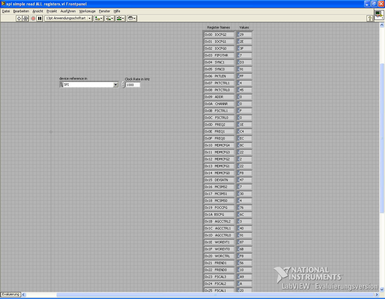

But funny thing, on Friday it actually worked. It read all the registers, I could actually write to them and reset the device. It worked about an hour before I left for home... and I was so happy. And today I come to work, and it is doing the same thing again. Now I know my program is not the problem!! I don't know what's going on with the board, but it works fine with SmartRF Studio and I left it exactly as it was on Friday, no changes, nobody touches my desk 😞

In case you want to see how it worked... and didn't work I put some images... because I did print screens so someone would believe I'm actually working.
Friday 🙂
Today 😞
Sincerely thankful,
Gisela
