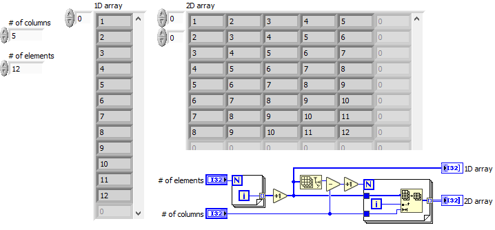

In this case simply use ArraySubset in a loop:
Message 6 of 10
(5,983 Views)

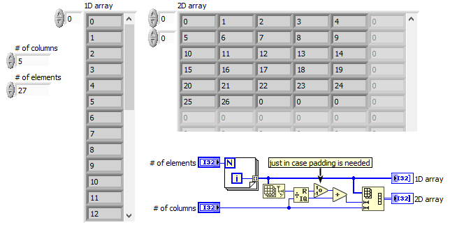

(Note that LabVIEW does not have a concept of columns vs. rows for 1D arrays. So you just have a 1D array.)
You also need to to decide what to do if the number of elements is not divisible by the number of columns, requiring padding of the last row.
See if this can give you some ideas....
Also note that reshape array does not touch the memory order of elements, so you might need to transpose at the end in different situations.
Message 7 of 10
(5,978 Views)
Accepted by topic author feller97
@feller97 wrote:
Output array
1,2,3,4,5
2,3,4,5,6
3,4,5,6,7
4,5,6,7,8
Sorry, I got distracted by the existing answers. Yes, "array subset" is the correct tool here:
Don't forget the +1 for N if using Gerd's code.
(On a side note, you are not really splitting the 1D array, but create a highly redundant 2D array that has many elements in duplicate. There is probably a better word than "splitting". for all this. For such sliding window operations, you might think about doing the subset calculation right there in the loop instead of building up these huge redundant data structures. Can you tell us a little bit more about what you are trying to do from a larger perspective?)
