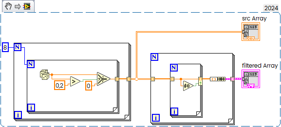

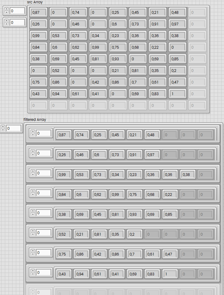

@Jee_with_a_J wrote:
so some rows might have 96/104 elements. These are then conditionally filtered in the for loop to produce a new array.
Looks like you needed kind of variable length arrays, here is typical design pattern already mentioned above:
result:
Message 5 of 11
