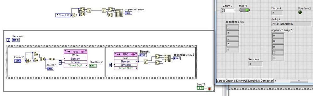

Above is the code, trial code on FPGA programming Where I have written some known data on the FIFO and
tried to retrieve it back. The split and join number are giving proper data as when done without FIFO and you can see the corresponding output in appended array.
With the same code executed with FIFO, executes but the result obtained is appended array 2.
Why is this change between these two methods?!!
Am not able to get this concept, where should the changes be done in order to get proper data.

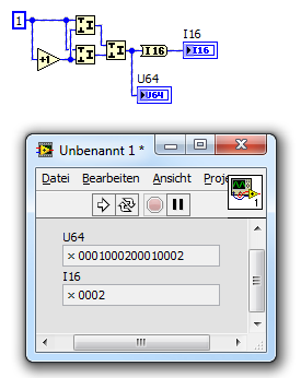

See this small test VI:
I use an U16 constant of 1 (similar to your count input), do the very same operations like you do and get the very same result - like you do.
So I think: LabVIEW does all the calculations correctly! 😄
What's the point of calculating an U64 value when you want to transfer just I16 values with your FIFO???

You're squashing a U64 into an I16, so you're losing the top three U16 values before it's put into the FIFO. Change the FIFO datatype to a U64 and you should be good.
