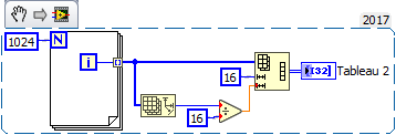

I would like to split a table that has 1024 points  into 16  splits  and each split then will have 64 points and i display them on 2D table  here is what i tried.
Thank you for your help.

It's not entirely clear what you want (or mean). Here's a start...
(4,004 Views)

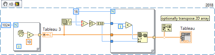

another try:
(3,999 Views)
YES, Reshape Array is much easier to use !!!

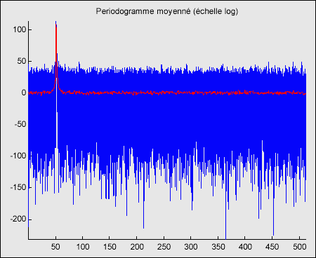

Hello CARYA,
In fact yes i am doing reshape to my data and then i will do an FFT for each line of my table  then after  that
i will make an average ( mean bloc) of the all  FFT's, i think we call that periodograme averaging
Thank you for your help guys
Résultat de recherche d'images pour "periodogramme moyenné sous matlab"
