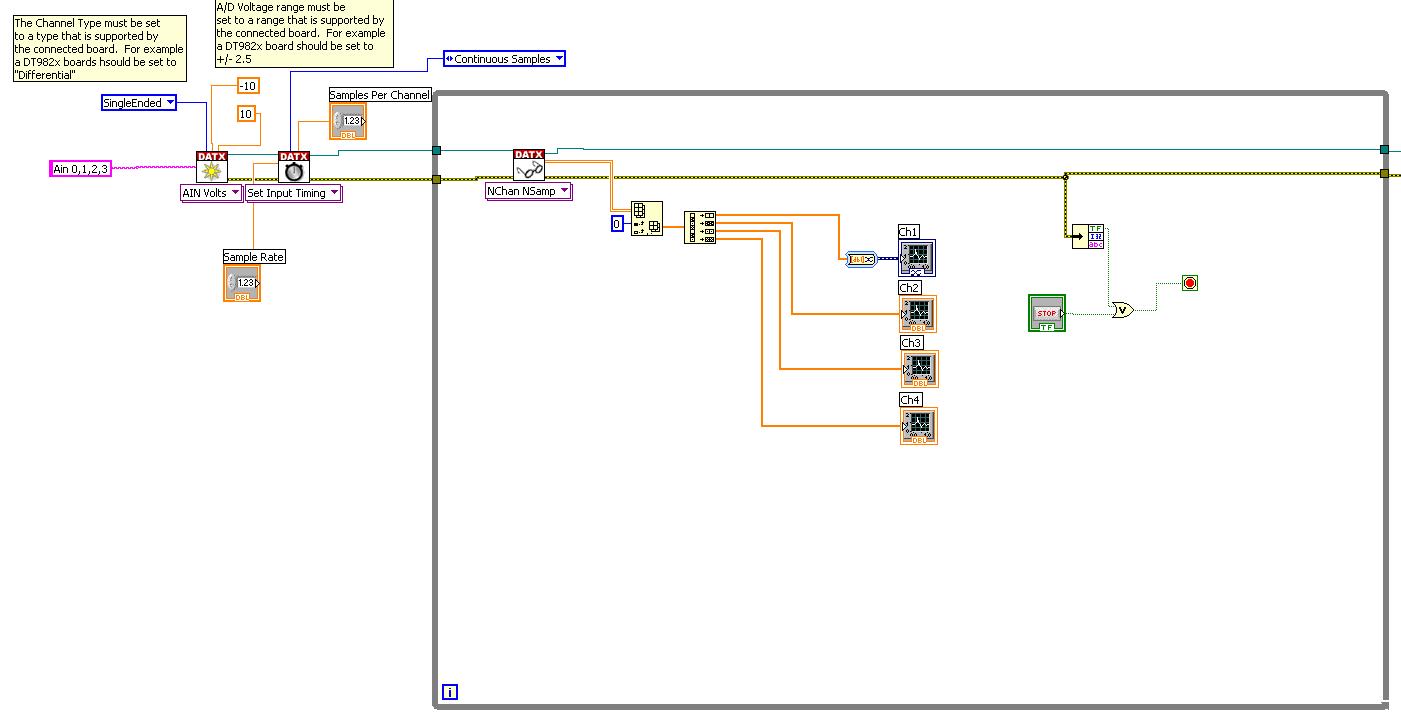

I have LV 8.5.  What I'm doing is taking 1000 samples for each channel on each iteration of the loop, then plotting them in order.  I'll eventually expand this to display an FFT spectrum as it changes dynamically for each channel.  I tested the below BD with only one channel hooked up, and the result is that all four plots show the signal that I'm putting into channel 1.  I don't understand why I need to index row 0 to get the signal out.  If I index the columns or index the row to 1, I don't get any signal output at all.

Can you post some actual sample data?  That would help in making sense of this thing.
Message 8 of 10
(4,530 Views)
Thanks for your help.  I resolved the problem... After looking at the sample data, it was not in the form the manufacturer said it would be in.  I was able to accomplish my purposes using the 'index array' function only.
