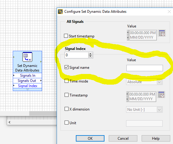

Add Signal Names to the SignalsSmiley Wink

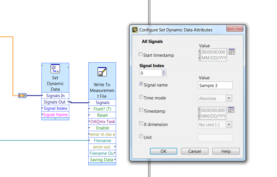

That got me closer, but I am still having trouble....I seem to only be able to change a single column.....Index 0 is column 0, Index 1 is column 1 etc....but I can't seem to change the value for each individual index.
Thoughts on what I am doing wrong?
(6,879 Views)
So I did an individual Set Dynamic Data for each individual index and wired them in series prior to the Write to measurement File VI....that works.
There might be a more efficient way to do it, but it worked.....thanks for the help!

If you leave signal index and signal name unwired the properties set in the express vi config should stick. (You may have missed the inc/dec arrows on the signal index control in the config page, you need to use them to set the reswt of the indexes at edit time)
