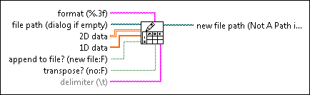

If you notice from the Help document on the Write to Spreadsheet File VI, you can see that you should wire a file path if you do not wish to see a Dialog Box Pop-up:
Right click on the blue-ish line that says "file path (dialog if empty)" and click "Create Constant".  It will make a blue text box that looks similar to a string.  This is a File Path data type recognized by LabVIEW.  Type in the file path -- something like c:\desktop\myfile.csv
Then it will not prompt you every iteration but rather will find the same file by following the path that you specified.
