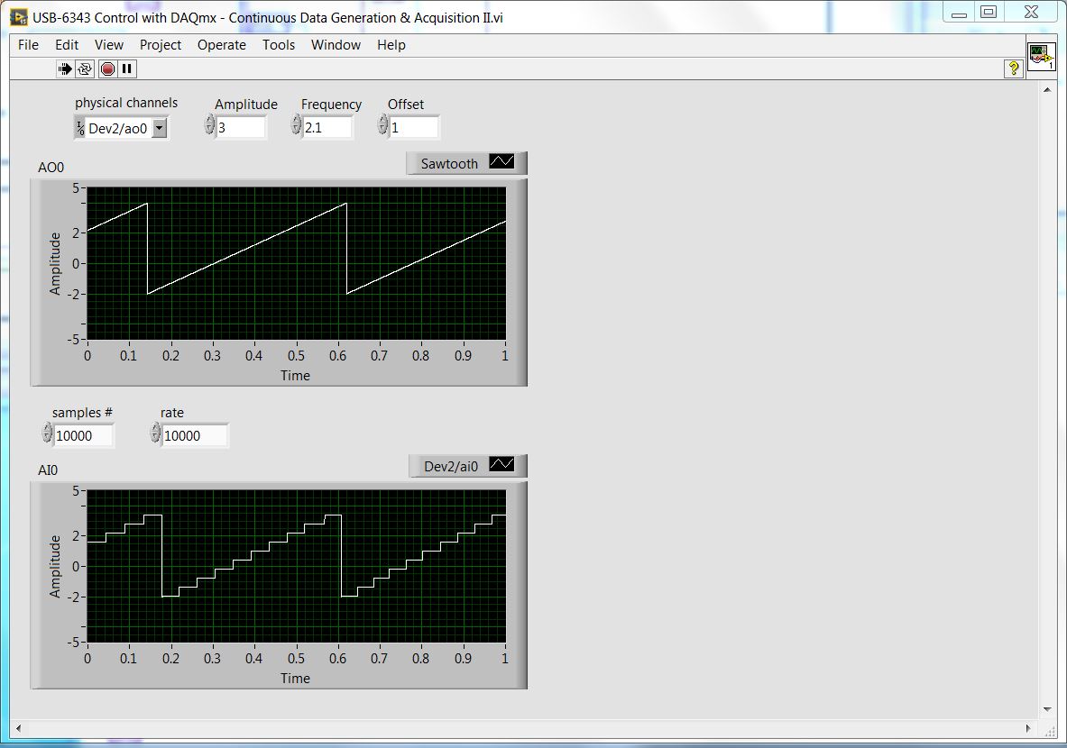

While using DAQ assistant for sawtooth generation, the shape of the output of my DAQ USB 6343 was quite perfect.
Recently (according to some advices on this forum) I replaced "DAQ assistant" by DAQmx blocks.
And with this last solution my sawtooth no more perfect, but staircase looking.
The bottom wavegraph is exactly the same that I observe on oscilloscope (AO0 is connected to AI0 and also to oscilloscope)
Probably I missed some parameter(s), while configuring my setup ?

Hi Pavel,

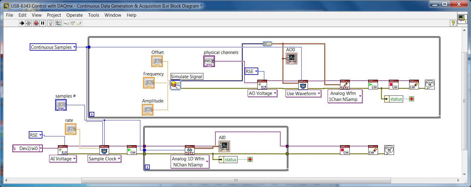

which sample rate and sample number have you configured for the SimulateSignal?
And why do you create and delete the AO task in each iteration?
I would also recommend to stay away from ExpressVIs.

Create a copy of the DAQ Assistant and then right click one of them and select "Convert to DAQmx Code" to see what you might have missed.

Hello GerdW,
... which sample rate and sample number have you configured for the SimulateSignal?
I've tried with 10000/10000 - the same as with "DAQ assistant"
I want to change the waveform parameters (amplitude/offset/frequency) in runtime. If I put create outside of the loop, I can't control waveform.
Probably you have a reason, but in all examples I've seen until now, "Simulate Signal" was used to define waveform.
Without doubts there are another techniques to do this job ... all suggestions welcome.
Pavel

Hi Pavel,
I searched for examples that don't use "Express" blocks for generating analog waveforms,
Have you searched for examples in the LabVIEW example finder? (Help menu…)
Do you mind to attach your VI?
Generation of the waveform (using SimulateSignal or any other function) is not related to your AO DAQmxTask.
You need to create the task just once before the loop and delete it once after the loop - the same as you do with the AI task!

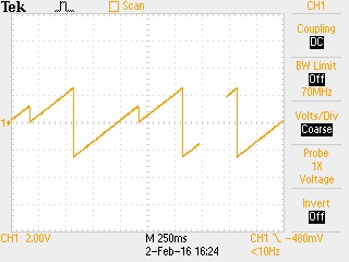

Only thing that troubles me is waveform on certain frequencies: when frequency is low and not "integer" (e.g. 1.24Hz as in the example below), the shape of waveform looks "broken".
Below is snapshot given from oscilloscope Tektronix TDS 2004C.
Is it issue of synchronization, or some particularity of device (USB-6343).
Best Regards
Pavel
Message 8 of 9
(5,284 Views)
Resolved - after a sending a series of samples, new series starts with phase = 0.
