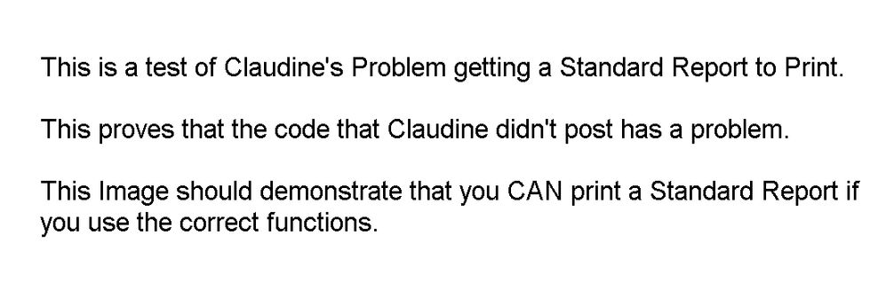

Thanks for your help.  Did you expect a "bare" RGT function to do anything?  I wrote a 5-function routine that starts with New Report (with Standard Report wired to the input) and ends with Dispose Report + Simple Error Handler.  Here is its output:
Print Test Proof.pngAlthough I don't show the function that adds text to the Report, rest assured that the above Text is what is in the String Constant I used.
Hope this is helpful.  If you want to see my code, please attach your (complete) code that you could not get to work.  I will be happy to explain, with reference to your code, what you did or didn't do.  Note that I'm using LabVIEW 2016 -- by attaching your code, I can tell the Version of LabVIEW you are using, and may be able to say "Oh, that doesn't work in LabVIEW 2006 ..." (there is no such version, by the way ...).

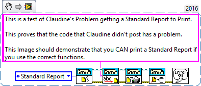

How curious!  Here's a LabVIEW 2016 Snippet of the VI I just ran:
As you can see, it is virtually identical to the one you posted.  There are, I believe, only a few differences:
  • Your code is in LabVIEW 2015, mine is in LabVIEW 2016.  I do not believe this accounts for the difference in behavior.
  • Your code uses Controls, where I use Constants, for Report Type and Text.  Again, this shouldn't be the difference -- indeed, I ran your code with "This is a test" and got printed output saying "This is a test" (running on the LabVIEW 2016 RTE).
  • We are using different printers.  I'm actually "on the road" with my laptop on my lap, not connected to any printer.  The Print Report function has a Printer Input that, if left blank (as both of us have done), defaults to the Default Printer.  I don't have a Default Printer defined, so I defined my Snagit "printer" as the Default Printer, and got the result(s) I expected.
Do you have a Default Printer defined?  If not, you need to specify the Printer in the Print Report function (right-click the Function and read the Help message).  Let us know if this fixes things for you.

Confession -- Since I'm "on the road" without a true printer, I also tried setting my default printer to Adobe PDF.  It also didn't work.  Since I have/use Snagit, and it installs a "Snagit Printer", I then tried setting the Snagit Printer as the Default, and it worked like a charm!
I have no idea why setting Adobe PDF as the "Standard Printer" would fail, but Snagit would work.  Well, I do have an idea -- when you print to Adobe PDF, you don't get a "generic" output.  It want to generate a named PDF file, which involves some sort of "behind-the-scenes" Magic.  For Snagit, it "prints" to an Image that can be saved as a PNG (which is what I attached), or can be sent to a "real" Printer.  I suspect that if my HP Whatever were set as the Default Printer, I'd have a piece of paper in my hand.
So my "best guess" is that you are trying to "print" to a non-standard "Default Printer" (Adobe PDF) that the RGT is not able to handle.
