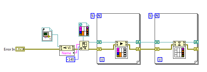

Will the order of the Start Asychronous Call match the order of the Wait On Asynchronous Call? I.E., if the VI was a straight pass through of an integer and you passed in, in order, 1 2 3 4 5, would the output be in the same order EVERY time? Since there is only one reference, and not a reference for every instance, I'm unsure. I assume the order can vary.

I'm not well versed in all the new clone pool options (I usually know how many clones I want and I open a specific reference for each one), but I suspect you are correct (i.e. my basic understanding is that at the ACBR node, LV will take a clone from the pool or create a new one and run it in parallel) and I can suggest a very simple check - add a random wait to the subVI and see if they come out in order. Like I said, I expect that you are right and they will not.

Try out this example project I built for internal training on these new options.  Parrallel loops are your friend here my colleges.
The Help file has quite a bit of detail, tips, tricks, caveats and examples for this topic. It is a little distributed but following the internal links will get you pretty deep.   some reading and playing will bring you up to speed quickly
