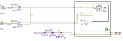

In this code, I am looking to generate continuous pulse signals soon as Start Task is run in the While Loop. However, although there are no errors thrown when the code is run, there is no signal output on the oscilloscope. Interestingly, the problem disappears if I move the Start Task outside of the flat sequence.
It is not obvious to me why the problem occurs; perhaps someone else has a keener eye than I do.

The task needs to be started before the trigger pulse is sent.  It would be like setting up your oscilloscope to trigger on a signal, but not enable the capture until after the pulse was sent, at which point you are just sitting there looking for the trigger signal.
