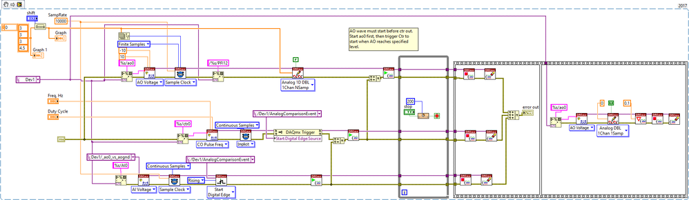

The single trigger property wasn't enough to fully configure triggering for the counter task.  Also, the AI task should be triggered by an analog signal level.  The Analog Comparison Event is a digital *result* of the analog task evaluating its analog trigger condition.
I made only minimal mods to illustrate with comments in cyan.
-Kevin P
Message 5 of 12
(2,140 Views)
-Kevin P
That works great! Thanks for clarifying and the marked up VI.
(AO=yellow, CTR=blue)

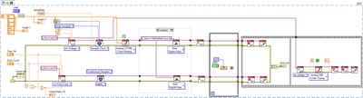

@Kevin_Price, one more question on the implementation of Option 1:
You mentioned "trigger both tasks off a common signal".  However, I'm at loss as to which signal to use.  There are many options for the trigger source of the DAQmx Start Trigger.vi such as OnbboardClock, various frequency TimeBases and reference clocks. Depending on which I choose, the actual delay varies (as seen on my o'scope).

When possible, I like to be the one that generates the trigger signal so that I can be sure all my other tasks are started and ready for it before I assert it.
With your X-series device this will be pretty straightforward.  Create a simple software-timed DO task that uses a single digital line, such as "Dev1/port1/line0".   Make sure you choose a digital line that performs double duty as a PFI pin!  Often this just means to use port 1 or port 2 rather than port 0 (which is often the only port that supports hardware-timed DIO and often doesn't support PFI-style signal routing options).
Your AO and CO tasks will configure their trigger according to the PFI pin designation.  For the sake of discussion, let's set it for rising edge polarity.  Then you will need to enforce the following sequencing:
1. Start your DO trigger signal task and set the line to Low.
2. Then start both your AO and CO tasks, which will now be armed and looking for a Low->High transition.
3. Generate a pulse by setting the DO line to High and then immediately back to Low.  You can now stop and clear the DO task because your AO and CO will be triggered and sync'ed.
-Kevin P

Thanks! I see how that's better, but then I still need a third DAQ terminal. 🙂 Is there no way to the syncing without taking up a physical terminal? Option 1 uses a DO terminal and Options 2 & 3 use and AI terminal.
Message 9 of 12
(2,027 Views)
A tweak to option 1 is to generate the triggering pulse with a 2nd counter task.  Then the other tasks would specify a trigger source like "/Dev1/Ctr1InternalOutput".
You can then *also* explicitly set this helper task's output terminal to be a null string "", and the signal won't tie up a physical wiring terminal.  You'll still use up an internal counter channel resource, but no terminals.
This is actually true for option 3 as well.  No physical wiring terminal is needed when you use the internally routed "_ao0_vs_aognd" channel for the AI task.  You still use up the AI subsystem though.
-Kevin P
