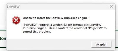

perdi los disco de  poliview labview  5.1
(1,222 Views)
if you are using an executable  built with LabVIEW 5.1.1, then you have to install the LabVIEW runtime engine 5.1.1
http://download.ni.com/#support/labview/windows/runtime/
