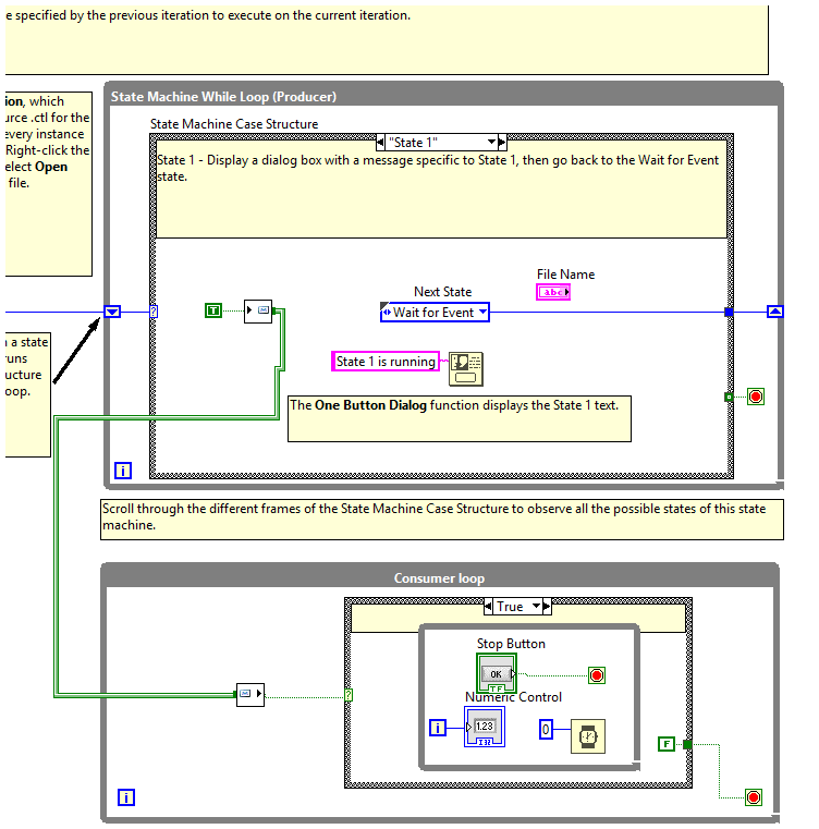

eems to me an example where a producer/consumer design would be best. I recommend that you look into that design pattern.
Quick example of how your example would work using channel wires (can be implemented using variables, queues, etc):

Thank you for the response. I did consider using producer/consumer however (at the time) my code was not processing much for the HMI screen so I opted for the state machine approach. Plus the approach seems more complicated with the messaging/notifications.  I will revisit it as I am considering on adding a step to display the error of the measurement for the operator. This will not be stored in the data file and warrant the producer/consumer pattern. I am not familiar with the channel wires. I am using LabVIEW 2015.
