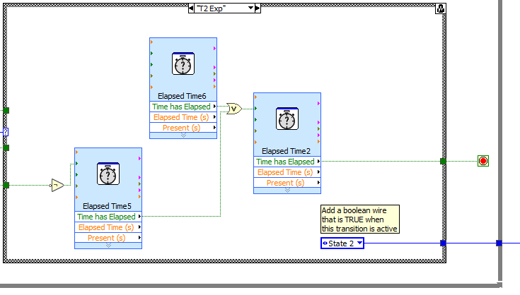

Added my code here.

That is one of the weirdest block diagrams I've ever seen. Unknown functions with no help, wires that can't be deleted and while loops attached to something else. I've never used the state diagram toolkit, but if that block diagram was created by that I might stay away from it. Seems like it's just going to make things harder in the long run. Look up basic state machines and go from there would be my advice.

Hard to follow what's going on, but what is the value of the "reset" wire going into some of the elapsed time express VIs. Since the booleans controlling these values are in the outer loop, any changes you do while the inner loop is running will not be read, of course.
Then there are very convoluted code constructs such a the presence of three different elapsed time express VIs stacked and combined into a single blob (picture). I am not ever trying to figure out what this is supposed to do. 😄
