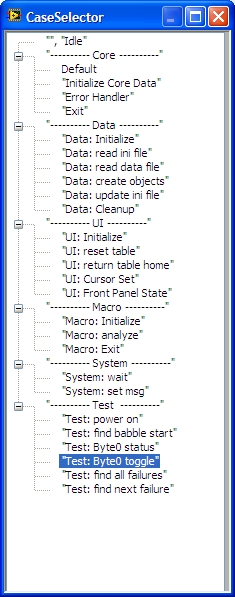

You could use the JKI State Machine.  My state machines look like this:
The CaseSelect JKI RCF Plugin makes working with this State Machine easier.
