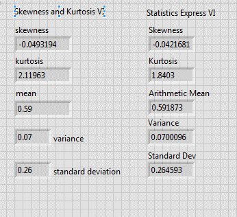

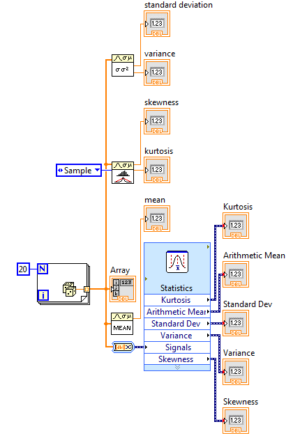

I am currently working with a data collection program from which I need to output the skew and kurtosis values for an array of 30 data points. As I was already using the Statistics Express VI to calculate mean, s.d. etc. I just added the skew and kurtosis outputs to that VI. I then set up a basic VI to generate a 1D array of random numbers to let me compare the Express VI to the skew and kurtosis VI on the mathematics > probability and stats. palette.
The skew and kurtosis values are inconsistent between the two VIs. If I calculate the skew and kurtosis by hand I can see that the non-express VI appears to be giving the correct answer. I did some digging and found that this has been labelled as bug no. 215683 and is described as having been fixed as part of Labview 2011. I am running Labview 2011 with SP1 so I'm not quite sure why the two VIs are still inconsistent.

Thanks for the reply, unfortunately I do not have access to a newer version of Labview. In this white paper, the bug is described as having been fixed between Labview 2010 and Labview 2011 which is why I'm a little confused as to why it is still occurring in my Labview 2011 installation.

The remaining data (StDev, variance) are provided by just another function from math->statistics palette…
You can also opne the ExpressVI to see, how it calculates those data and why it does produce different results!

The fix for bug 215683 was to add the non-express VI on statistics palette.   The express VI assumes the input sequence is a complete population to calculate the skewness and kurtosis.
The non-express VI gives the option between population and samples.  And the default option is samples, which is a more valid option in other software.
We will add more description in the document to help user understand the difference between these VIs.
